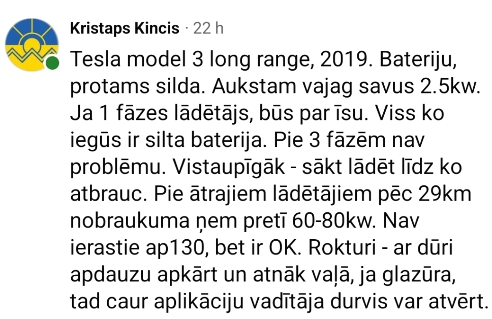

Te interesanta pieredze ar Tesla Model 3.
